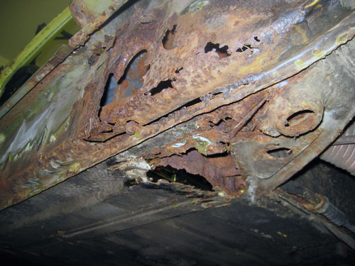

More rust (what would a 914 be without rust):
Any suggestions for removing the jack support and tube? Do I need to cut more of the rear fender off and some of the door jamb?
OK, this is scary. Can you say swiss cheese?
