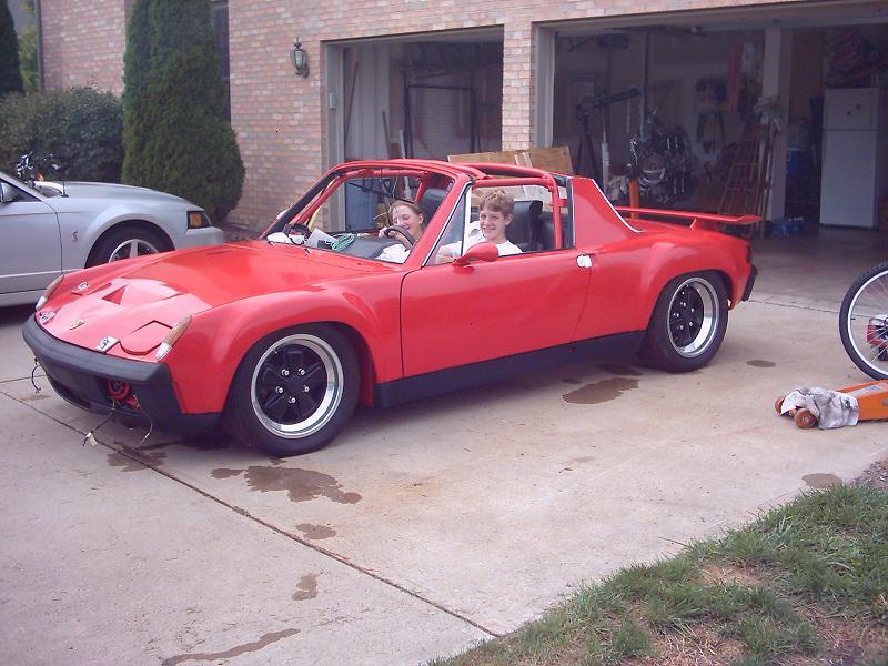

Attached Imagehere.

dflesburg   Here are links to how I did it through the hood......   Jan 18 2007, 08:29 PM

dflesburg   Thanks, that pic was Labor Day 2006, you should se...   Jan 19 2007, 01:19 PM
