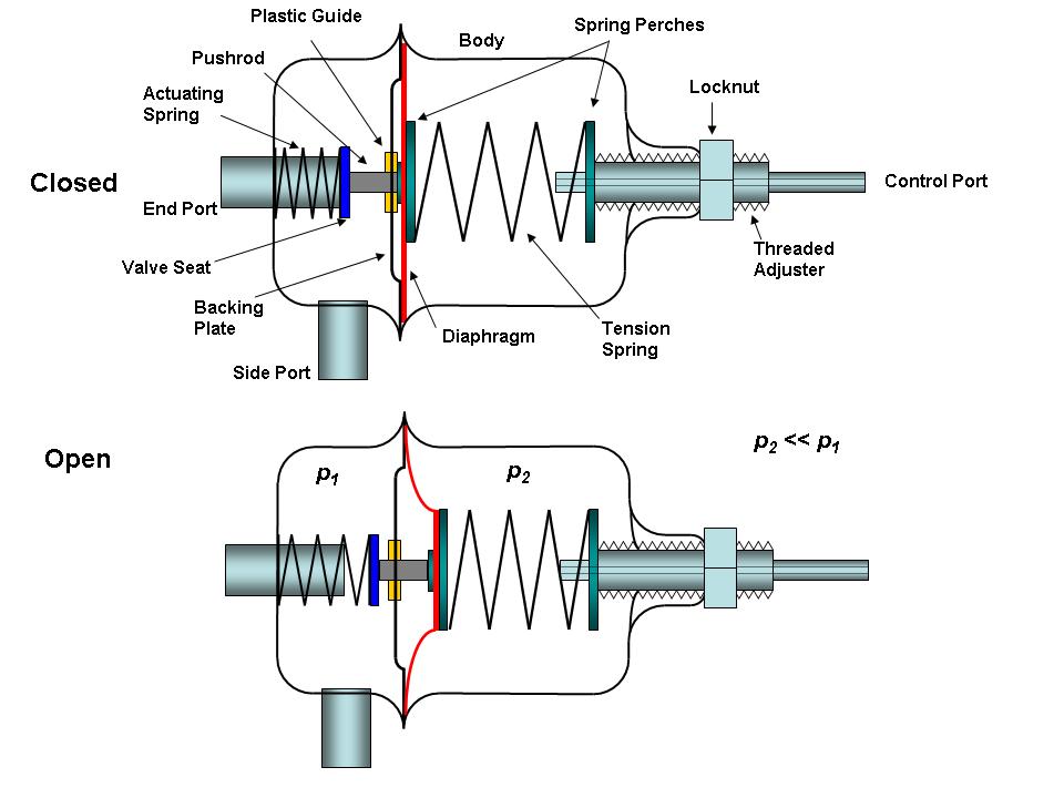

OK, here's what I think the guts of this thing look like, open and closed - if you want to see the picture more clearly, click on it to open it in a separate window:

pbanders   OK, here's what I think the guts of this thing...   Jan 26 2007, 05:54 PM

John   I like the diagram, but I still don't see anyt...   Jan 26 2007, 11:28 PM
pbanders   I like the diagram, but I still don't see any...   Jan 27 2007, 08:43 AM
