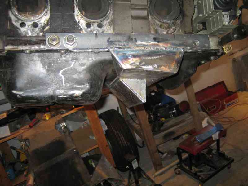

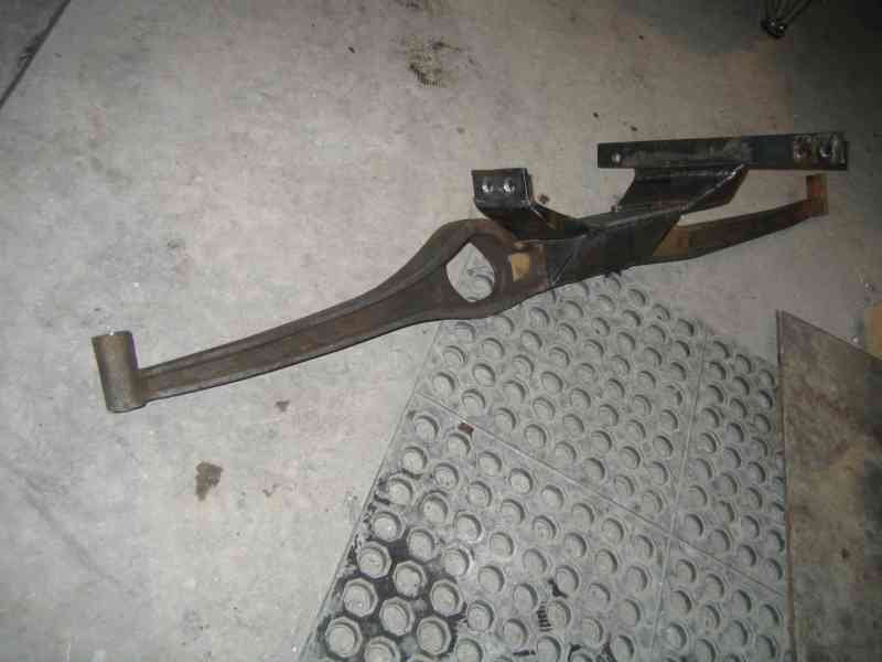

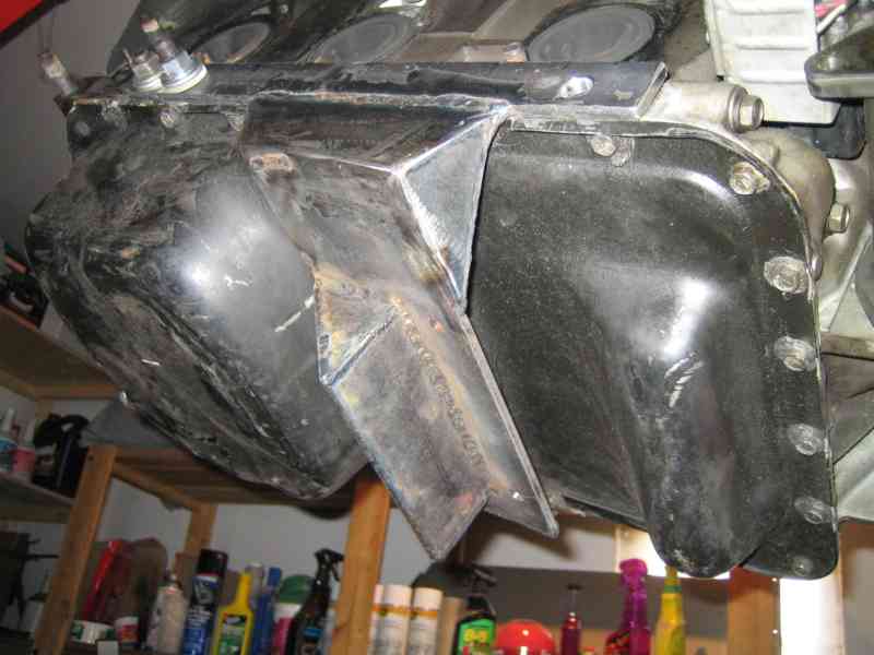

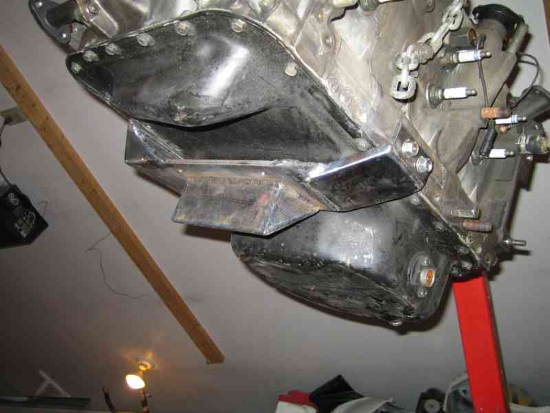

Just a little update here. The engine mount is done and ready to go to painting and powdercoating along with the mounting bar. My builder did a really good job in building the mount in my opinion. It sits tight on the engine and uses existing bolt holes - in fact on the exhaust side it uses the engine mount holes. There is one hole that we have to tap but that should be minor. The mount bolts to the engine and then to the bar which in turn uses the factory mounting points. Feel free to comment with your thoughts guys. Here are some pictures:
