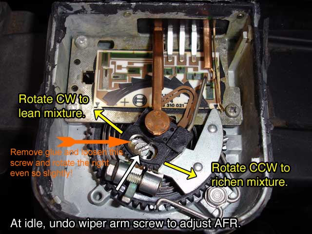

I know that because of the Air mass sensor on the L-jet it can handle some slight increases of displacement without too much trouble. Engine sucks in a little more air and it compensates with-in reason.
So I'm wondering where the line is if you just increase the bore size where the L-jet will not be able richen the mixture enough. 96mm, 100mm, 103. I've heard some guys use the 1.8 L-jet on the 2.0, so a 10% increase. So if your starting with a 2.0 bus L-jet system it should be able to handle 2.2 liters, right?

Reset the AFM by moving the arm.
You must use a O2 sensor to determine the Air fuel Ratio as you move the arm.
I use a LM1 meter

MrKona   How does one recalibrate the AFM? What does this ...   Mar 4 2007, 10:17 AM
Bleyseng   Reset the AFM by moving the arm. You must use a O2...   Mar 4 2007, 10:28 AM
Brando   After re-calibrating the AFS you can then change y...   Mar 4 2007, 10:51 AM
ClayPerrine   The only other thing you will need to change for B...   Mar 4 2007, 11:03 AM
Bleyseng   Yes, you will have to adjust the spring tension on...   Mar 4 2007, 03:30 PM
