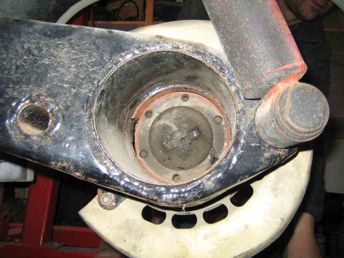

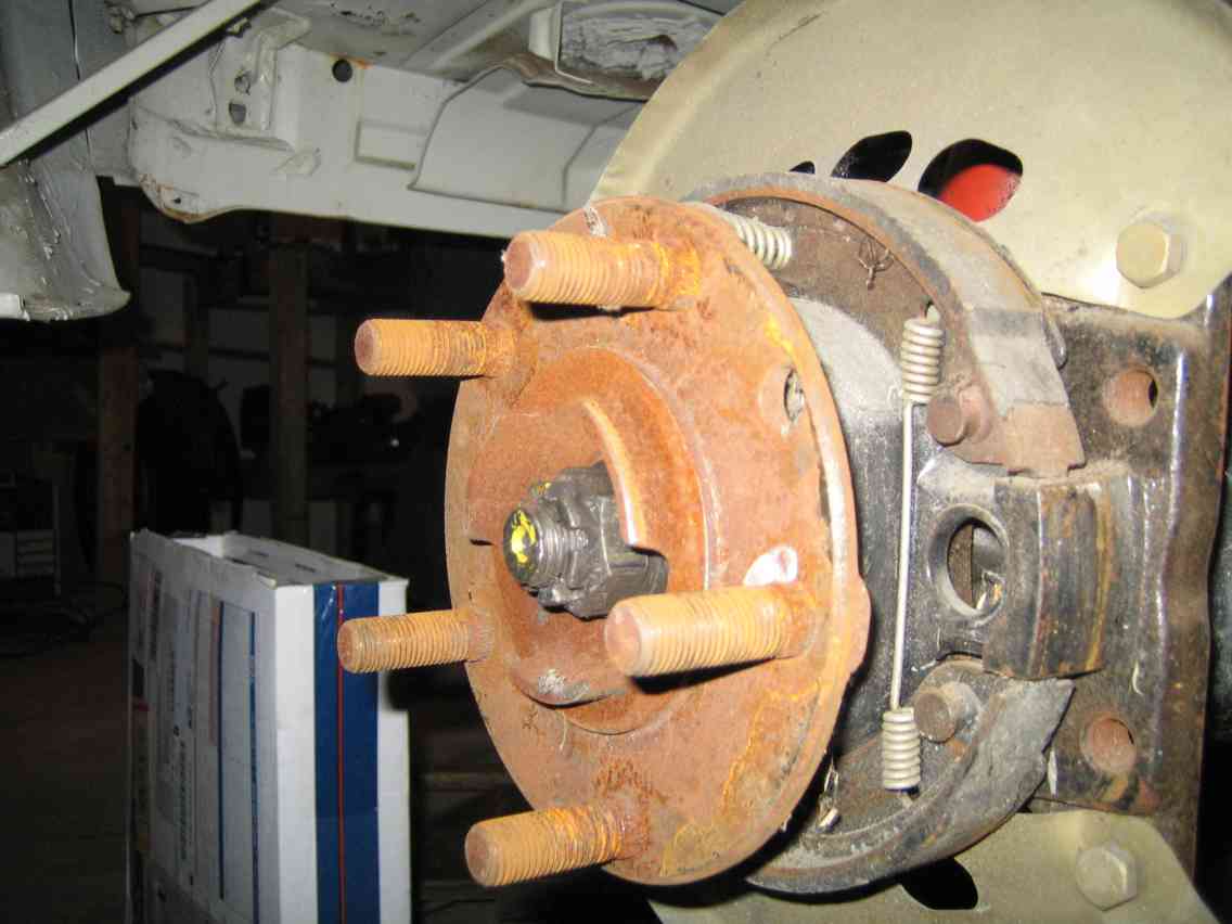

This is where we are at today. Paul is also going to work on the brake system for me. I have purchased a set of front and rear 1990 911 C2 calipers and rotors for this car. I will need adapters for them as the caliper bolt spacing is different than what is on the car. If anyone has information on where to get the adapters please let me know. I also purchased a pair of early 911 axles but the look to be too short and the bolt pattern on the inner CV doesn't match the output shaft of the transmission. Any ideas here are welcomed as well.
I've also wondered about the rear hub conversion that was done. Can anyone here tell me if these look like 914-6 units are are they just a drilled out hub with an extra bolt in them? Any help identifying what I have is appreciated.
