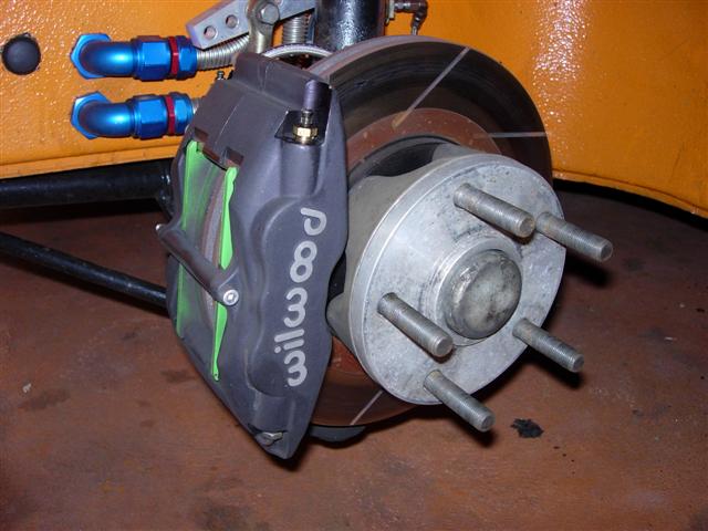

You mean something like this:

Matt Romanowski   Is there a reason why no one considers running Wil...   Mar 20 2007, 06:34 AM
soloracer   I wasn't aware that there was a Willwood solut...   Mar 20 2007, 10:56 AM
andys   I wasn't aware that there was a Willwood solu...   Mar 20 2007, 11:07 AM
Aaron Cox   as mentioned... alot of wilwoods bolt up to 3.5...   Mar 20 2007, 11:16 AM
Matt Romanowski   I posted pictures of my setup. A search should fin...   Mar 20 2007, 01:10 PM
