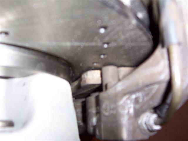

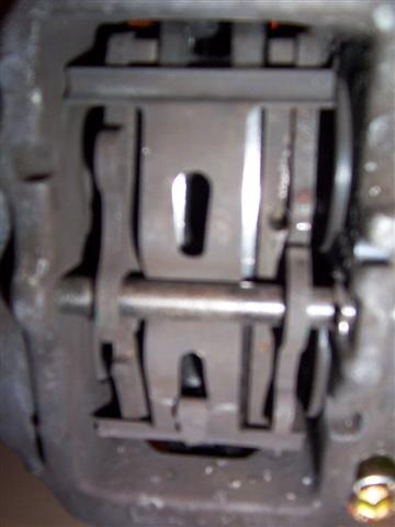

I dont have any brake pad over hang on my boxster setup.
Just looks like it.

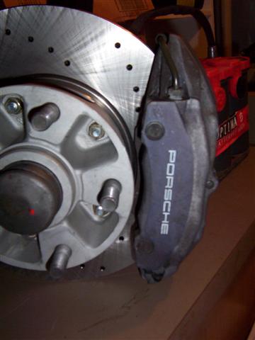

Aaron Cox   craig downs and i are working on it. this pic sh...   Mar 19 2007, 10:59 AM

smdubovsky   Aaron, That pic says it all. Tnx. The holes stil...   Mar 19 2007, 01:57 PM

Aaron Cox   yep... that looks like the TRE kit. thats the bolt...   Mar 19 2007, 06:08 PM
craig downs   With that pic even with the 3.5" spindle and ...   Mar 19 2007, 08:23 PM

Luke M   I dont have any brake pad over hang on my boxster ...   Mar 20 2007, 03:39 PM
