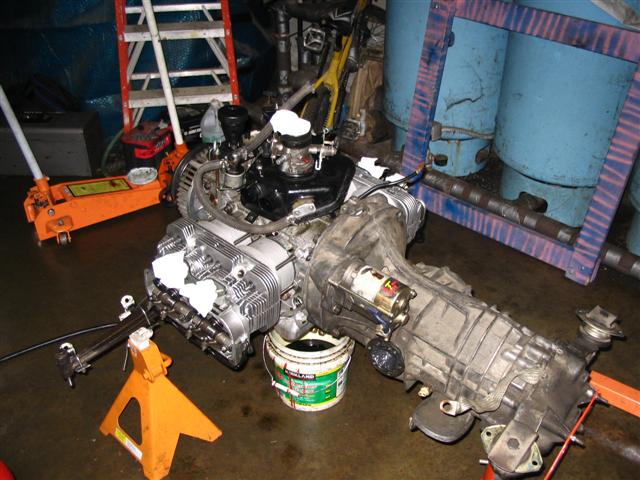

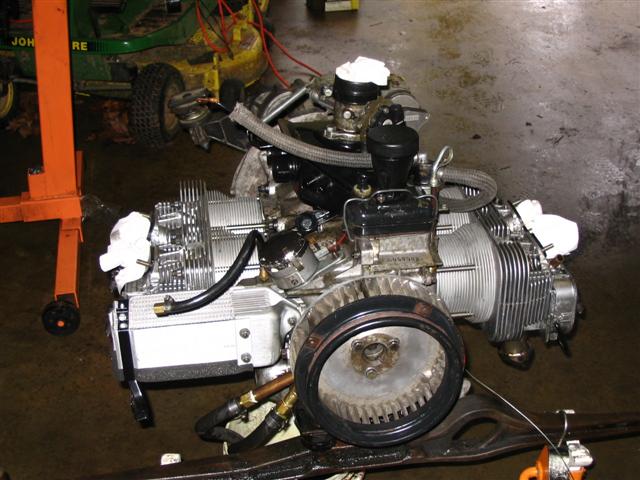

Party at my place Saturday. Beer and garage talk starting at 1:30 or so. Beer provided in exchange for opinions as we teardown my engine. Searing of fat and protein will happen about 5:00

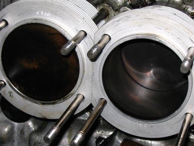

Ok since I had the camera I was elected to post the findings.
(IMG:style_emoticons/default/sad.gif)
Attached Image Attached Image Attached Image Attached Image Attached Image Attached Image

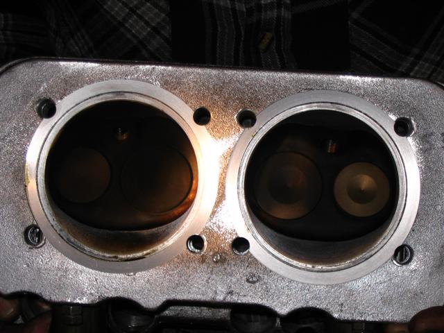

prior to tear down plug color was good (not to lean) but leak down #'s were BAD.
Nothing obvious after removal of heads.

rdauenhauer   Cylnders come off and the cyl walls tell a diff. s...   Mar 25 2007, 02:08 PM

DNHunt   Further work today. Cylinders 1,3 and 4 all had br...   Mar 25 2007, 04:41 PM
Jake Raby   Lean, Lean Lean!!!!!!...   Mar 25 2007, 04:44 PM
DNHunt   Jake You are right about the detonation. I told e...   Mar 25 2007, 05:07 PM
Jake Raby   Yeah, let us get the TV show out of the way and th...   Mar 25 2007, 05:19 PM
