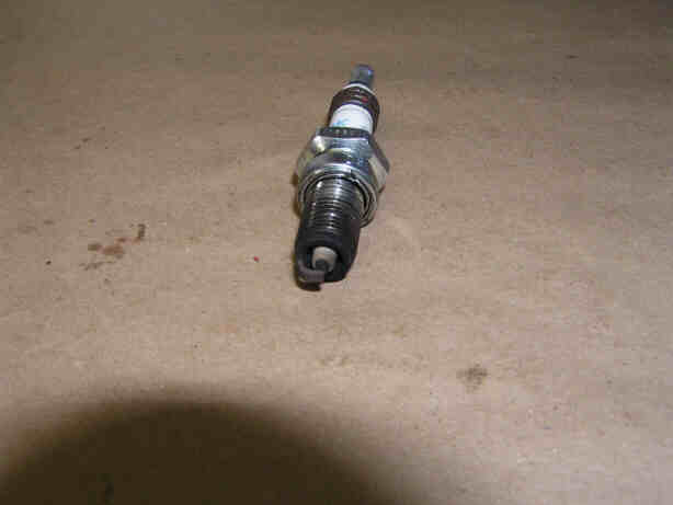

Here's the plug pics Jake.
cyl #1

DNHunt   Here's the plug pics Jake. cyl #1   Mar 25 2007, 07:10 PM

Jake Raby   Dave, I need closer pics... Get them as close to t...   Mar 25 2007, 08:12 PM

DNHunt   Here you go Jake, plug 1   Mar 25 2007, 08:48 PM

Jake Raby   I see what appears to be proof of detonation on th...   Mar 26 2007, 08:17 AM
Joe Ricard   Holy crap those are lean. Agree on the detonation...   Mar 26 2007, 11:58 AM
