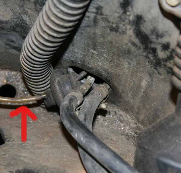

Finally got around to removing my gas tank so I could put in a front sway bar, and I'm happy to report that I didn't find any rust. Just pine needles,
and old wrench and some crappy work by whomever removed the tank before regarding not using the grommets for the brake lines and gas lines. After doing so I now have a couple of questions I'm hoping someone can answer: 1st: Here are the wires that go to my fuel pump, and a third (arrowed) that I'm hoping someone can tell me what it goes to? (It wasn't plugged in when I pulled the pump.) Attached image(s)

2nd: I thought I understood the fuel system (to some extent anyway).
1 line from the tank to the fuel filter, then the fuel pump, then through the center tunnel and then back to the engine. 1 line that returns from the feul injection back through the center tunnel to the gas tank. What's this 3rd line that's going into the tunnel? I think I disconnected the top from the plastic 'breather box' (or whatever it's called) that sits on top of the gas tank. Is that why the inside of my car sometimes smells like gas when the tank is full or near full? Attached image(s)

davep The third line should be the vent line that goes t... Apr 2 2007, 09:31 AM
Rob Ways The sway bar mount looks fine. It looks like an af... Apr 2 2007, 09:38 AM
rjames
Thank you for the responses. :beer1: This m... Apr 2 2007, 03:25 PM
McMark AFAIK, black/red is supposed to run the fuel pump.... Apr 2 2007, 04:51 PM
