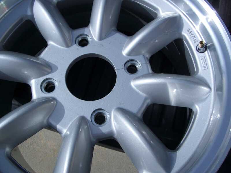

I had half a dozen titles for this thread in my head...
It's finally time to mount the Superlite wheels I bought in June 06. Mike Z was given a second chance offer from ebay when the auction didn't make reserve. He offered them up and I grabbed it. I bought them significantly cheaper than Pack Racing currently offers them for on their website. So it was worth it. Here's the original thread There were many questions (and even a little mis-information) in that thread. I'll answer quite a few here since I now have the wheels have tires mounted on them and I'm about to use them.

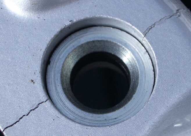

So I took the wheels/tires to the Big O Tire shop where I bought the tires originally to have the tires dismounted so I could drill the Superlight wheels for the inserts. Got the wheels all drilled, sent an email to the local gang looking for a shop press to install them (since my press is at Kevin's). Turns out the tire shop has a press and will let me use it. So I go back down there and start pressing inserts into wheels. As I finish each wheel, they are mounting and rebalancing tires on them. Everything's goin great, I'm on the last insert on the last wheel...
*CRACK*!!!!!!!!!!!!!
I put one crank too much on the press and the damn wheel cracked!
I ordered a $175 replacement. That puts my total investment into these things at $560. Still a deal considering they cost $175 each for these wheels new. This cracked wheel will look great on the garage wall next to my "labor of love" polished Fuchs wheel.
