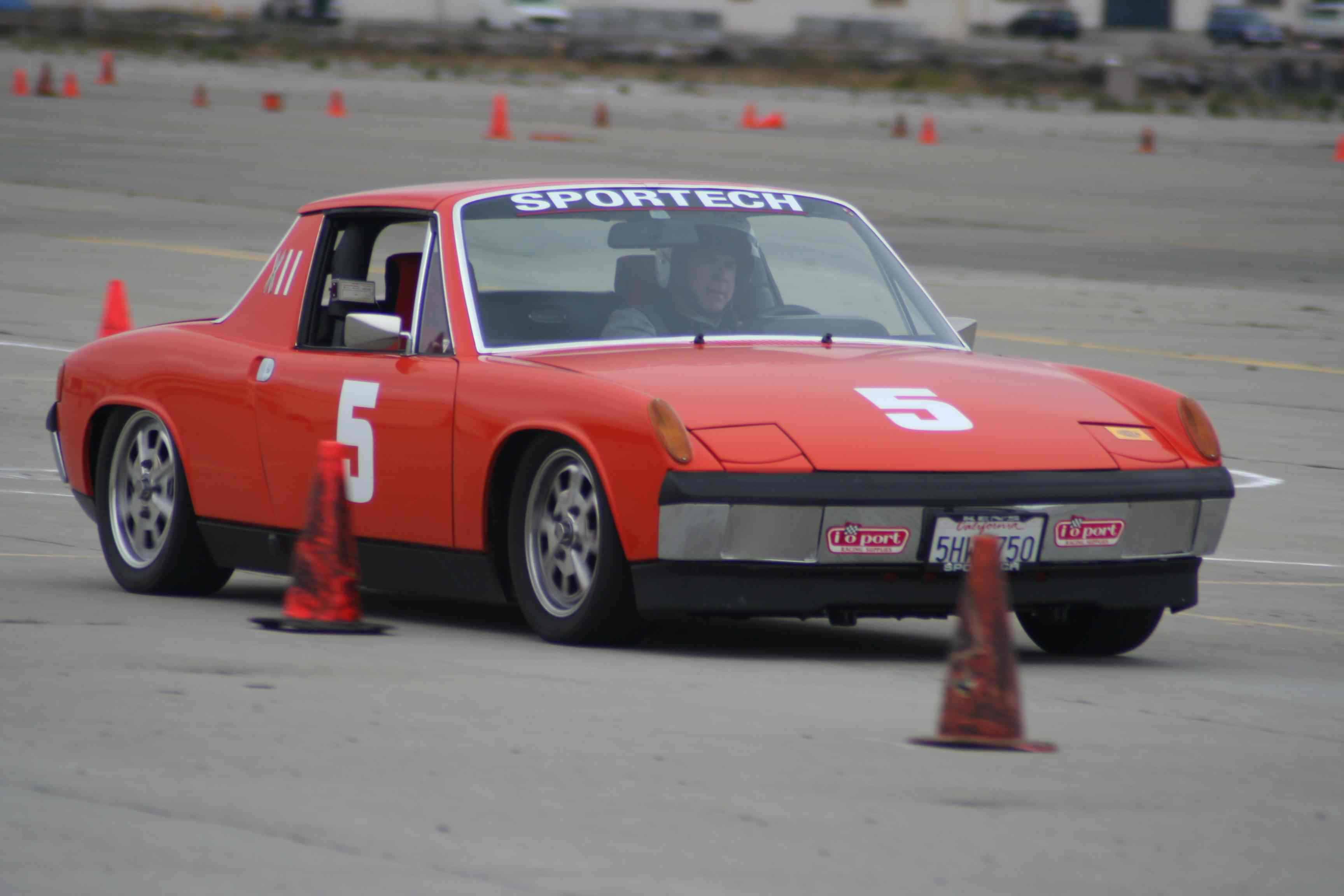

My current track car runs Koni adjustables, 21mm torsion bars and a stock sway bar up front. In the rear I run Bilstein sports with 180# springs. with very aggressive lowering and lots of negative camber.
