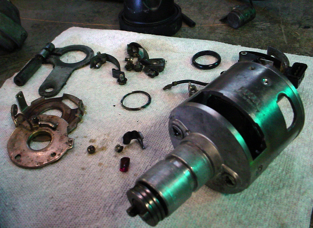

Here are some of the dirty dirty dirty parts:
(IMG:http://www.914world.com/bbs2/uploads_offsite/farm1.static.flickr.com-179-1555377241.1.jpg) |
