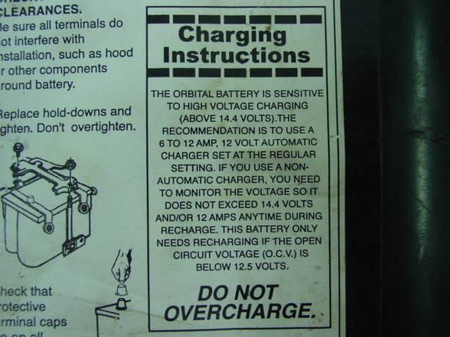

I have an Orbital battery in my car. This was supplied by NAPA auto. It is a little over 2 years old and now it won't hold a charge. The car was stored inside and it was kept from freezing. The battery was very low when I went to start up the car this Spring. It did crank so the battery was not fully discharged. I charged it up and the car started. Next morning dead again. I had an Optima in my van for several years without any problems. Has anyone here had problems with the Orbital battery? It is in pro rated warranty period now. NAPA wants 120 to replace it. I paid 120 for it. A new battery is 140. Some warranty.

I left my battery in slow charge overnight. I checked it this morning with the charger still running. It read 15.6 volts! Here is a pic of the charging instructions off the battery.
I really wonder if this is what causes the short life and if my cay may also be doing something similar.
