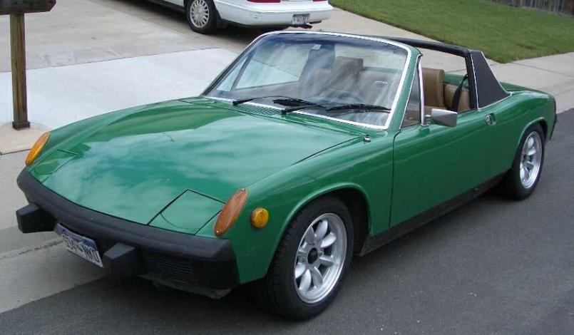

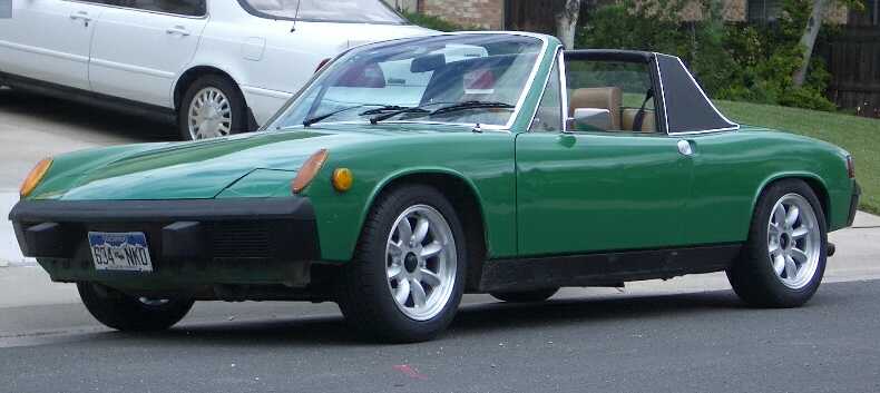

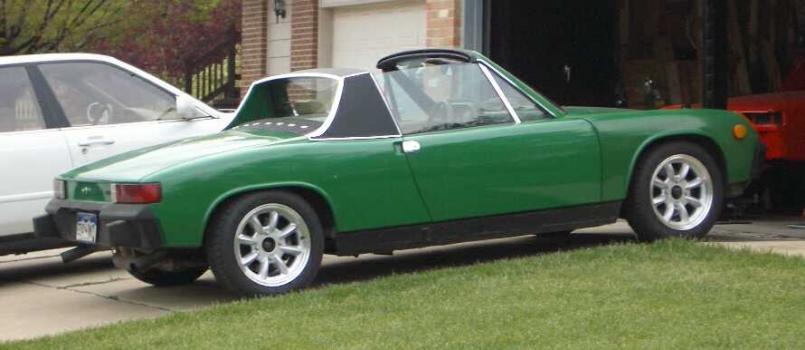

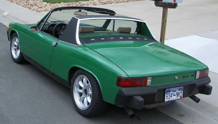

It's been a long road...
My $360 deal on Superlight wheels ended up costing $900 by the time it was all said and done. If I hadn't broken that one wheel, I still could have come in under the $750 shipped cost of a set of new wheels from Superlight.
But, these are now custom 30mm offset wheels. My new bolts are even long enough with these wheels for some spacers in the front. I may still add them. We'll see...
