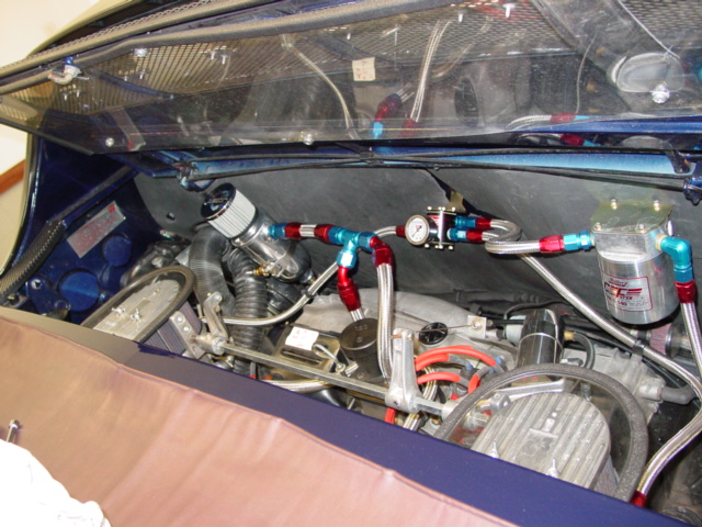

Here's my example, fuel Y block right in the middle on the fire wall (IMG:style_emoticons/default/biggrin.gif)

akellym   Here's my example, fuel Y block right in the m...   May 8 2007, 06:17 PM
lotus_65   Mine are really close to the same length. I have a...   May 8 2007, 06:23 PM
lotus_65   Kelly, mine's not as attractive but functional...   May 8 2007, 06:34 PM
