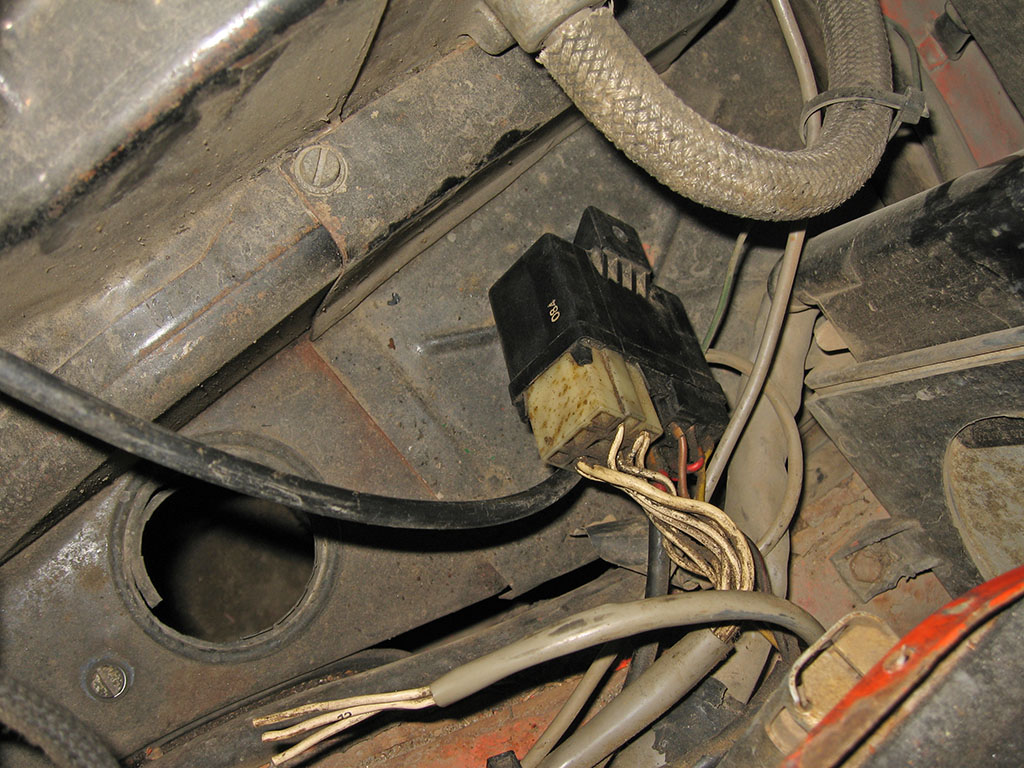

I appologize for not giving information my car. For some reason I thought my profile showed my car info but I was thinking of another forum.
It is a 1974 with the 1.8L.
Dave, I found that dual relay. It wasn't attached to anything and was just laying on top of the engine. I unclipped the connectors and removed it. Visually it appears to be fine.
I did notice 3 wires that weren't connected to anything, although it looks like they were cut, not broken. I'm not sure where they come from but the 3 are bundled together and then they run into another wire housing that contains other wires so I'm not sure where it leads to.
I can't get it started at all anymore. Still no indication of the fuel pump running.
I'm attaching a picture that shows the dual relay and the disconneted wires in the bottom left corner.

Dave_Darling   Those look to be fuel injection wires--they're...   May 10 2007, 09:22 PM
#1RAGE   Yes, I believe that is a 12 on the wire. I pushed...   May 11 2007, 07:00 PM
Dave_Darling   The click is probably the dual relay--if it is, th...   May 11 2007, 07:48 PM

#1RAGE   We plugged in the relay, turned the key to the on ...   May 16 2007, 08:03 PM
#1RAGE   Can anyone tell me how I would test that dual rela...   May 29 2007, 11:41 AM
Marlow   http://manuals.type4.org/ljet/ Go to the 'Com...   May 29 2007, 01:02 PM
kwales   Square relays are easy. Listen for clicks when ac...   May 29 2007, 08:13 PM
#1RAGE   Hey thanks! Took the relay apart and found e...   Jun 14 2007, 06:37 PM
#1RAGE   FINALLY! Got a new relay, put it in, put the ...   Jun 28 2007, 11:08 PM
