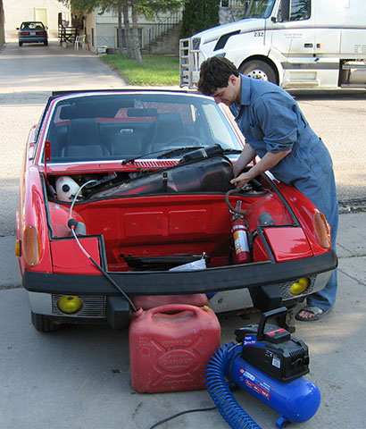

Alright, made some more progress today.
Got a good buddy of mine to help me. We pulled the gas tank out and the fuel pump was underneath it.
We're not experts on the electrical stuff so hopefully someone here can help.
We disconnected the fuel pump and hook it up directly to a battery and it seemed to work fine. When we pumped a bit of clean gas with the pump out of the car, the gas coming out was very dark and dirty looking... that can't be good, can it?
Then we tested the voltage of the wires going to the fuel pump, at the fuel pump end. We got a reading of 0.25 V no matter what position the key was in. When we unhooked the white connector on that relay (picture in my earlier post), we got 12 V but again no difference with the key on or off.
What does that indicate? Shouldn't I be getting 12 V only when the key is turned on? Is there any way to test the relay?
