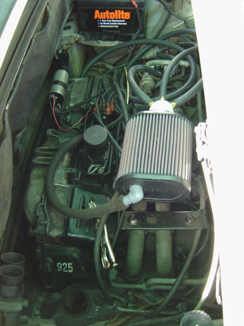

BahnBrenner914   OK, here's the pics of the engine:   May 19 2007, 07:20 PM
BahnBrenner914   and the driver side:   May 19 2007, 07:21 PM
Dr Evil   You still hae the air injector pipes in the heads ...   May 19 2007, 07:38 PM
BahnBrenner914   You still hae the air injector pipes in the heads...   May 20 2007, 01:26 PM
