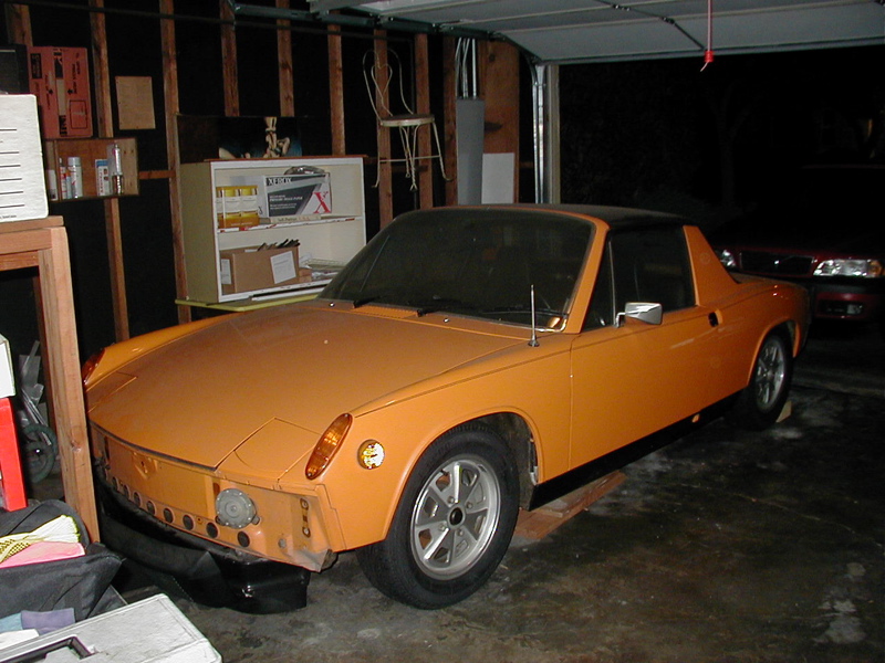

little history of the car...
the car is a 1973 porsche 914, my dad purchased the car new in 73, he drove the car as a everyday driver for 7 years, got a job in atlantic city and did not want to put miles on it driving it to work so he purchased a nissan stanza to drive everyday, from 1980 to about 1986 the car was started here and there and maybe driven around the block, 1986 was the last time the car was started and it was parked in our garage never to be seen again! 5 years ago at my college graduation the title of the car was turned over to me and it was given to me as a present to do with what i please,...
that brings me to about a month ago when i finally had the gonads to pull the cover off her and she what it was all about...
(IMG:http://i3.photobucket.com/albums/y93/jimtweet18/Picture039.jpg)
so i got home from work early one day and decided to head to pep boys and buy a battery and just see if i could get any life at all....to my suprise it almost cranked over,...checked the distributor and there was no spark...replaced distributor, rotor, wires, plugs...tried again and nothing...flue lines where dry, so bad fuel pump, bought a used fuel pump for 150$, installed with two new fuel lines and she fired right up
