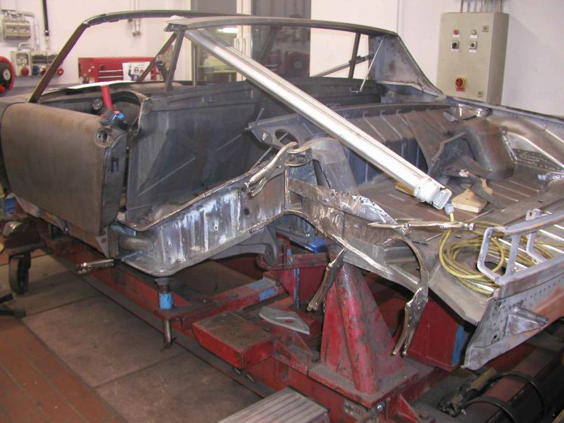

I hacked into my parts car to gain an even clearer view of the world inside the long. I'm here to share my pictures. (IMG:http://www.914world.com/bbs2/html/emoticons/wink.gif)
Here's how I hacked in. I wouldn't recommend this tactic on a real project, but I just wanted to get inside without losing the shape and perspective of things. I just took a hack saw and cut into the top of the long and then drilled out all the spot welds along the top.

(IMG:http://www.914world.com/bbs2/uploads/post-1658-1180394778_thumb.jpg)

McMark   Opened up. You would never be able to get the met...   Mar 29 2005, 08:28 PM
McMark   Here's the paper, plastic, fiberglass, and alu...   Mar 29 2005, 08:31 PM
McMark   Here's the long without the tube. Notice how ...   Mar 29 2005, 08:34 PM
McMark   Here's a detail shot of the rear of the openin...   Mar 29 2005, 08:37 PM
McMark   Here's the front of the opening showing the fr...   Mar 29 2005, 08:39 PM
McMark   View towards the rear of the long. Here you can s...   Mar 29 2005, 08:41 PM
McMark   Here's the view towards the front of the long.   Mar 29 2005, 08:42 PM
McMark   Here's a view to the rear, past the heater tub...   Mar 29 2005, 08:45 PM
McMark   Another detail show of the seat belt reinforcement...   Mar 29 2005, 08:47 PM
McMark   Here's [i]one possible way to remove the tube ...   Mar 29 2005, 08:51 PM
McMark   Finally, a shot down the paper tube, showing the a...   Mar 29 2005, 08:53 PM
