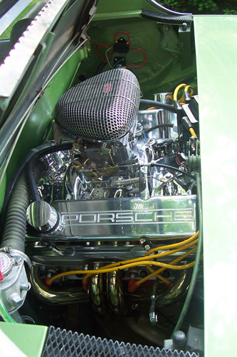

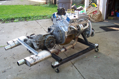

Got the 305 out and put the 302 in, runs pretty well.
I am running an edelbrock 600,
Hydraulic roller cam .56 lift 236/236 duration.
I am in the process of tuning it right now. I have HEI vacuum advance hooked up to the timed port on the carb.
The engine has some lope to it, when I advance the distributor to smooth out the idle, it purrs like a kitten and no spark knock. The problem is when I advance the ignition timing this far, it is difficult for the starter to turn over the engine.
Here is what I am going to try, please tell me if this makes sense:
I was going to put the vacuum advance on the manifold vacuum port, thus giving more advance at idle, I do not think this would affect the initial start up advance, making the starter able to turn the motor over when hot.
here are some pics
Thanks
Mark
PS, the car is a bit quicker now, the power comes on at 3000 RPMs, so it is very driveable around town with the power where it needs to be.

pffft   ... Is the distributor vac advace or retard? Ma...   May 31 2007, 12:26 PM

914-8   Nice! Be careful with that air filter. Most ...   May 31 2007, 12:40 PM
rick 918-S   Nice! Be careful with that air filter. Most...   May 31 2007, 12:55 PM

marks914   Thanks for the input, The Dizzy is a summit bluepr...   May 31 2007, 02:45 PM

marks914   Hooked up the vacuum gauge and I have 7hg" at...   May 31 2007, 09:26 PM
byndbad914   Hey Mike - I am going to just kinda reinforce a co...   May 31 2007, 11:11 PM
marks914   Its runnimg better. I changed to lighter step up s...   Jun 2 2007, 05:17 AM

marks914   Got it idling decent finally. I got an accel adv...   Jun 6 2007, 06:08 AM
