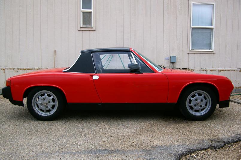

I have two 914's, a 75 and a 76. I got sick and tired of screwing around with the valve eating VW Type IV piece of sh*t engine in them both so decided to replace both with Buick V6 engines, a fairly straight forward swap as engine swaps go in a 914 (no way I can afford any Porsche 6 cyl motor).
The red 75 was the first recipient of a basically stock 3.8 liter, only mods were an Edelbrock intake, small Holley 4bbl, MSD distributor and ignition, and headers. Plenty of power even in that basically stock configuration. The white 76 is awaiting an already built 4.1 liter (now 4.2 liter) Buick V6 with JE 9 1/2 to 1 forged pistons, cc'd and flowed heads, Isky cam, Manley stainless valves, Isky springs, retainers, lifters, etc. The White 76 will be basically gutted to reduce weight but will remain a street ride.

After installation and off the jack stands... minus glass front bumper.

dbledsoe   Here's my engine/trans setup before installati...   Jun 19 2007, 02:42 PM
dbledsoe   This is a pic from below just after installation.   Jun 19 2007, 02:46 PM
dbledsoe   This was the last valve that went in my Type IV.   Jun 19 2007, 02:48 PM
dbledsoe   Radiator, fans, battery relocation, etc.   Jun 19 2007, 02:51 PM
dbledsoe   After installation and off the jack stands... minu...   Jun 19 2007, 02:57 PM
