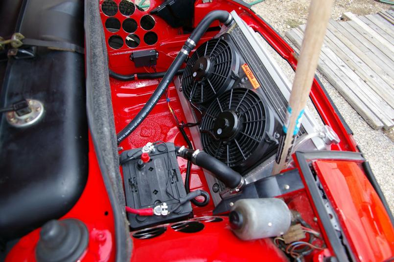

dbledsoe   Radiator, fans, battery relocation, etc.   Jun 19 2007, 02:51 PM

ruddyboys   Car looks great, just wondering, with the holes cu...   Jun 19 2007, 04:23 PM
dbledsoe   Car looks great, just wondering, with the holes c...   Jun 19 2007, 04:47 PM
