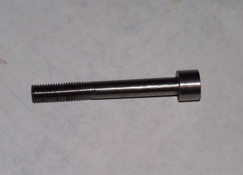

Just to re-enforce this fact (that I am nuts) When I rebuilt my front calipers one of the bolts snaped off. The bolt is a 9mm, try to find one of those in the U.S.! NOT - but you can buy 9mm taps and dies.
Well my solution was to take a 10mm bolt chuck it up in a lathe turn it down to 9mm and the run a die over it.
mmmm Beer would be good, just no straight jackets.
