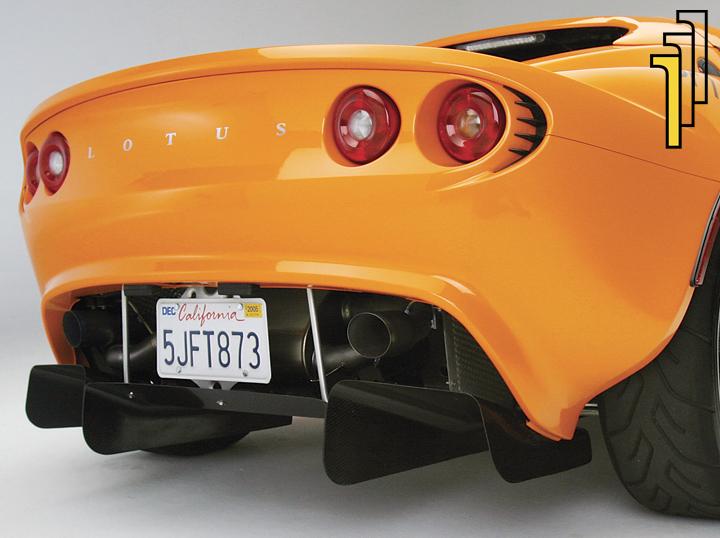

I want to make a diffuser/engine pan for my car, and last night I started gluing foam sheets together to make a mold. My plan is to form the foam into the shape I want and then seal it with body filler, and then primer and polish. I have been reading up on making molds for composite work and most seem to talk about making a copmosite piece for the mold rather than what I am planning. If I make my mold as described will my composite part rip the mold apart when I seperate the two? (assuming I use a PVA mold release film).
Also, if I make the part with carbon fiber, how do I finish the edges of the piece when I'm done?
I would like to vacuum bag this part because the part will be visible from the top and the bottom... Can I get away not bagging it and get a decent finish? (I'm not super concerned that it has a perfect surface really).
-Tony
Finished part will look something like this...
With the long straight edge meeting up against the firewall and the two tunnels exiting right under the bumper.

From the reading I've done, it seems that 10-12 degrees for the tunnel is optimum. For a 6 inch high tunnel exit that means 31 inches long. It will probably make a difference at high speed, but it will be far from optimum..
Here's a nice diffuser... (~$1100)
