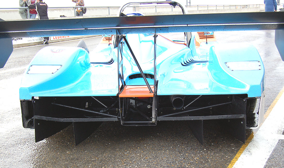

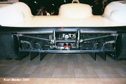

I've been kicking around bilding one for my race car and have collected several dozen pictures. here are a few
