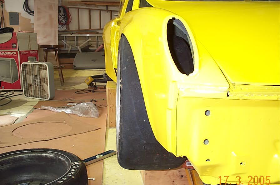

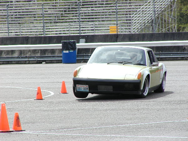

Odd, I checked my front camber as I pushed it to the bump stop. It gained negative camber all the way....maybe sumthins' bent. This pic isn't quite all the way, but the angle on the tire is more revealing.
Body roll, we got some.
I think you are overstating the effect on camber of a strut suspension or taking something out of context. Also, caster adds camber to the outside wheel as one turns which is why AXers run as much caster as they can get.
I may be fulla shit, but pics don't lie.(IMG:style_emoticons/default/biggrin.gif)
Then again, I read your post more carefully and find we agree....put it down as a senior moment.....my work here is done.(IMG:style_emoticons/default/confused24.gif)

QUOTE(J P Stein @ Jul 16 2007, 08:01 PM) *
Of course you gained camber. Just follow the geometry. As the a-arm rotates upwards, the hub goes with it, and as it pivots up, gains negative camber.
It's not just the suspension movement to consider. As the body of the car rolls, the strut top moves with it, and because the strut is directly coupled to the a-arm, if there's body roll, the strut will loose some negative camber. In some cars, this is really severe. In other car, not as big a deal.
You betcha!!! (IMG:style_emoticons/default/biggrin.gif)
Yes sir... I think it's time for... (IMG:style_emoticons/default/drunk.gif)
