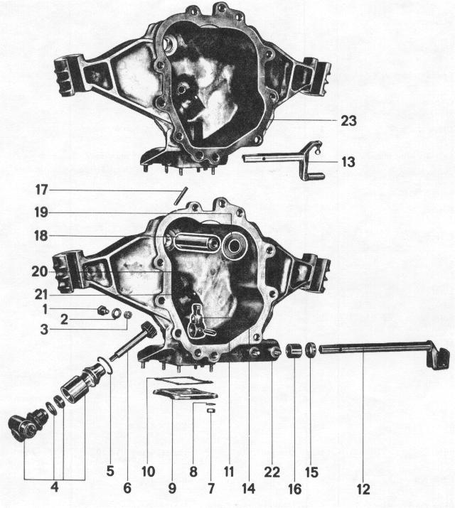

Found this exploded view, looks like its in the #4 stackup.

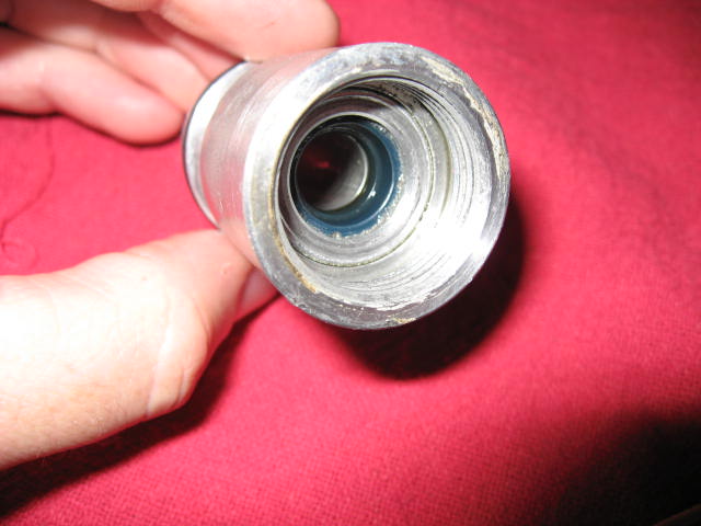

Pulled my angle drive off and think I found a blue seal in the housing part.
