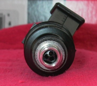

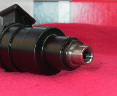

Forget to reply to the Mercedes injectors- they're specced for a 1974 450SE. In theory, they flow the same as our 2.0 injectors, but they have the straight hose. I found a lot better availability and pricing options- take a look here-
http://www.partsamerica.com/ProductList.as...r=Fuel+Injector
I picked up the Niehof for $50 each brand new. Plus, the Niehof has updated design on the nozzles- similar to 1990's vintage GM.... it's a ball seat instead of a needle.
Attached ImageAttached Image
I have no idea if they're any good, but so far they're working fine on my 2.0L. I queried this forum and no one had any experience with them, so I'm trying them.
Jim
