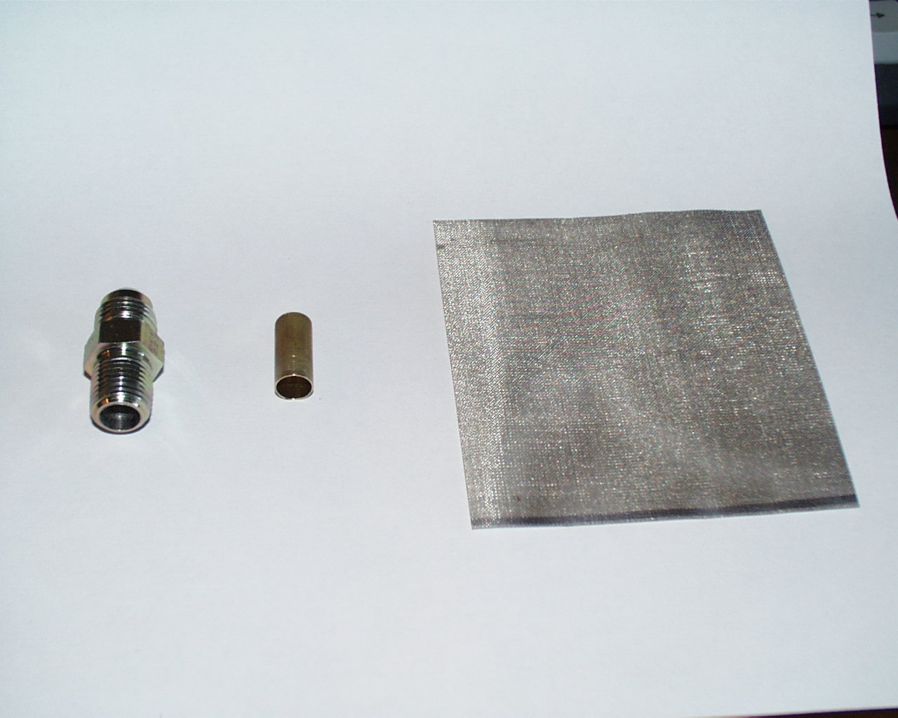

Phoenix-MN Next - silver soldered the tube to the AN fitting... Jul 19 2007, 07:55 PM
Phoenix-MN Finally - Soldered the wire tube to the brass and ... Jul 19 2007, 07:59 PM

andys Paul,
Nice job.
What mesh is the screen? Also, ... Jul 19 2007, 11:20 PM
Phoenix-MN skline,
Sorry, I really don't want to get into... Jul 20 2007, 07:30 AM
