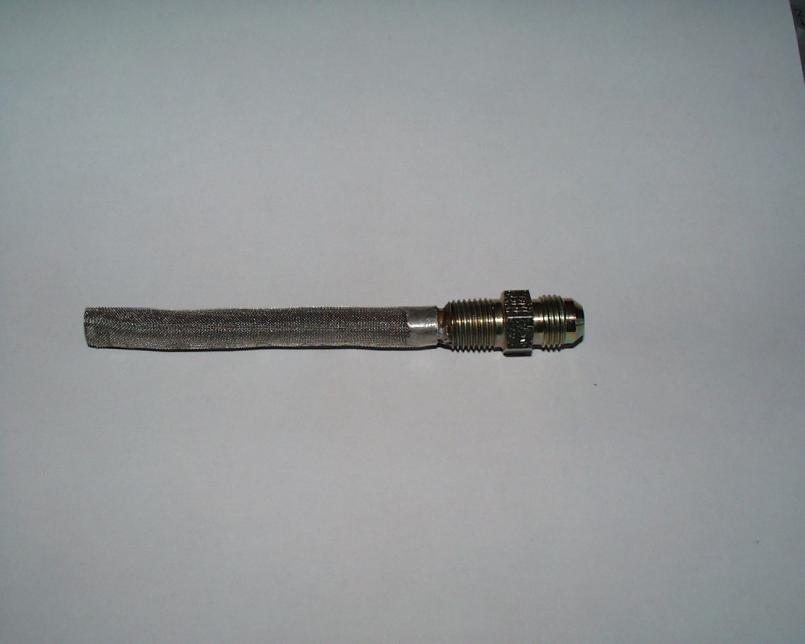

Finally - Soldered the wire tube to the brass and crimped and soldered the end. It's rugged, removable, and easily cleaned. (IMG:style_emoticons/default/biggrin.gif)
Most excellent ingenuity! (IMG:style_emoticons/default/pray.gif)
Put me down for one should you decide to make up a batch.
Everyone should order this from you-rust is inevitable...
AK
