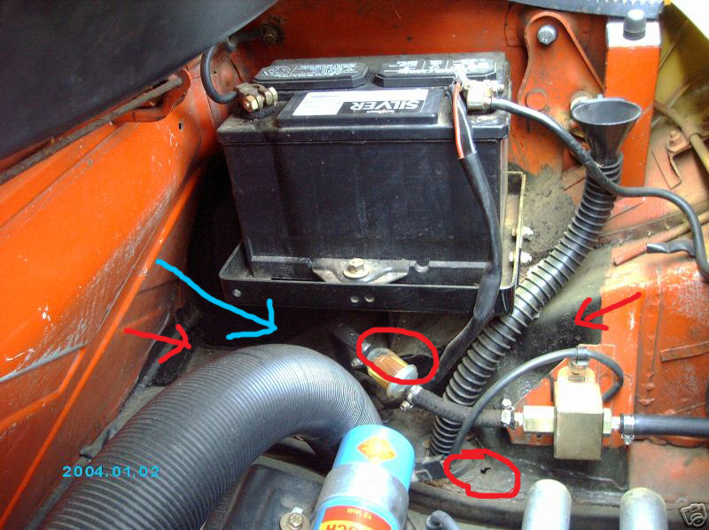

Hey everyone,
I'm looking to purchase this 914, I'm going to see it on Saturday. It's currently being listed on ebay. First Question, is there anyone in the Charlotte, NC are are willing to come with me to see this 914? Also, what should I be looking at on this 914? He mentioned a 4inch diameter hole under the passenger seat that has rusted completely through but has been "repaired" I need advice on what are some things I should look at on Saturday. Also, what are some of your guys opinion of a fair price for this one?
Here is the link to the car:
http://cgi.ebay.com/ebaymotors/Porsche-914...sspagenameZWDVW
Thanks and hope to get some good responses! Here is the description & some pictures, more on ebay!
1972 Porsche 914 Targa 1.7 Liter 5 Speed Daily Driver
Vehicle Description
914 has had extensive restoration to drive train, all new fuel system,brake system. Bushings on pedal assembly, converted to weber carb, new tires , new exhaust system ,new heat exchanger.new hoses on everything ,new heater blower, fresh paint, orginal color orange, console with guages, blue dot blauplunkt radio , driven daily, a side shift trans would make this a perfect car 30+ miles per gallon....Front pan perfect...Rear Pan perfect...Battery Box Perfect...some rust repair where firewall joins seat pan Pictures tell the story..will e-mail more photos
GWN7

Take a look really close at the areas I've circled in Red...Rust .....and note the black paint (Red Arrows)....Take a really close look at the area under the battery tray (Blue Arrow) to see what it looks like......
If the rust repair was that extensive (Black paint area) I'd be wondering what the long looked like right under there from battery acid washing down on it over the years.

Grelber   According to his camera, those pictures are 3 1/2 ...   Jul 20 2007, 07:35 AM
mudfoot76   According to his camera, those pictures are 3 1/2...   Jul 20 2007, 08:17 AM
sendjonathanmail   just poke at everything....watch for that rust rep...   Jul 20 2007, 07:53 AM
SteveL   If the floor under the passenger seat by the firew...   Jul 20 2007, 08:13 AM
swl   All of the above! my personal favorites: p...   Jul 20 2007, 08:20 AM
terrymason   It's a nice looking car, and it can be hard to...   Jul 20 2007, 08:30 AM
swl   The good news: The interior is in really good shap...   Jul 20 2007, 08:32 AM
chewy   Thanks for the input guys, The guy I spoke with sa...   Jul 20 2007, 08:59 AM
chewy   Could there be any explanation for the trunk are b...   Jul 20 2007, 12:26 PM
swl   Just guessing. The black stuff was probably rust ...   Jul 20 2007, 12:41 PM
SirAndy   i don't think he's honest with you about t...   Jul 20 2007, 12:55 PM
GWN7   Take a look really close at the areas I've cir...   Jul 20 2007, 01:10 PM
terrymason   Maybe I'm more forgiving than most on the cond...   Jul 20 2007, 01:23 PM
dr914@autoatlanta.com   With the single carb, the color change, the rust a...   Jul 20 2007, 01:31 PM
jaminM3   I'd pay $4K max.. It does look pretty go...   Jul 20 2007, 01:46 PM
dr914@autoatlanta.com   For example there are two customers cars here. On...   Jul 20 2007, 02:05 PM
orthobiz   For example there are two customers cars here. t...   Jul 21 2007, 08:54 AM
Joe Owensby   I live in Spartanburg, and could perhaps come up t...   Jul 21 2007, 08:28 AM
