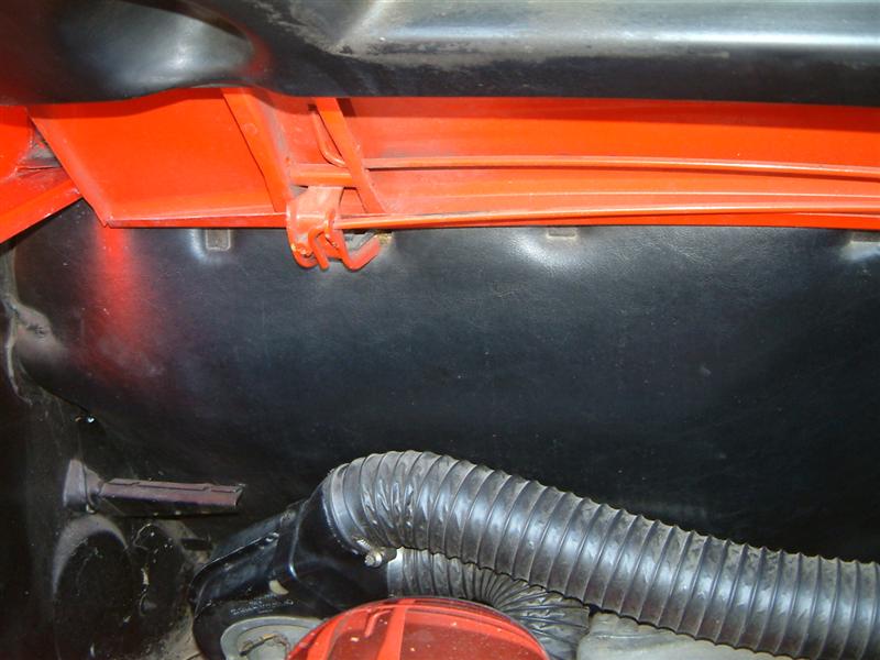

As some of you know, I just bought this car a couple weeks ago. I'm seriously looking into doing a facelift on the car such as new paint, some interior, and detailing the engine bay. I pretty much know what needs to be done body and interior wise. Now I'm trying to determine what the engine bay will need. I'm not going for an original resto, and plan on keeping the carbs. I'm thinking it may just need a battery tray and painted. Some of the wiring looks ugly, so maybe that can be straightened up. Is that firewall pad stock or something that was added? Everything seems solid as far as rust goes. What looks bad to you guys?

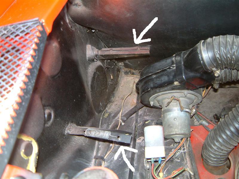

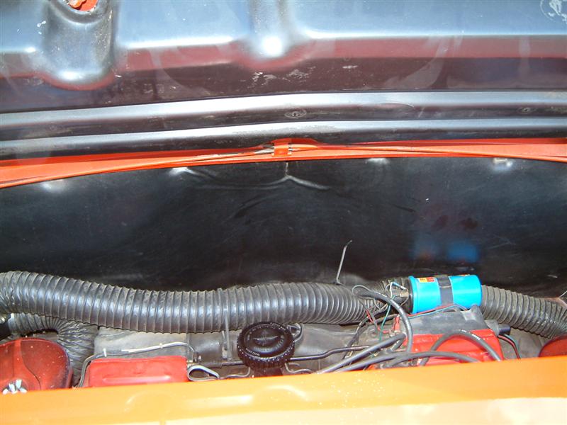

There are no horizontal splits. There are little tabs along the top that look stock, but not sure how else it is held on. I took a couple better pics.
Also, what were the brackets for that I have arrows pointed to in the last pic? Attached image(s)

As some of you know, I just bought this car a cou... Jul 20 2007, 05:47 PM
Ferg That one to me appears not stock...
I don't ... Jul 20 2007, 06:02 PM
swl I'm thinking the same as Ferg. I also don... Jul 20 2007, 06:13 PM

Also, what were the brackets for that I have arro... Jul 20 2007, 06:49 PM
swl fuel injection relay panel
That says some major r... Jul 20 2007, 06:52 PM
Slick914
That says some major ... Jul 20 2007, 07:11 PM
swl yeah - that attaches to the relay panel - lol.
Wh... Jul 20 2007, 09:13 PM
Slick914
W... Jul 20 2007, 09:18 PM
swl the lever opens a gate on the warm air elbow as we... Jul 20 2007, 09:47 PM
Slick914 Thanks for the help man. Looks like I have a bigge... Jul 20 2007, 09:50 PM
swl be careful - restoring it could be a huge job if t... Jul 20 2007, 10:02 PM
rhodyguy using the relay board is the BEST method for power... Jul 21 2007, 08:10 AM
Dave_Darling That looks like a non-stock firewall pad. No slit... Jul 21 2007, 10:04 AM
Slick914 Thanks for the explinations. I now have a better i... Jul 21 2007, 01:23 PM
swl with the relay you only need a small amount of cur... Jul 21 2007, 01:38 PM![]() ![]() |
