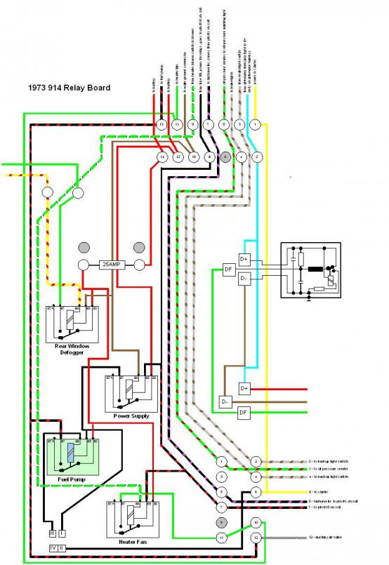

with the relay you only need a small amount of current passing through the switch. That switch probably was engineered for that low current and probably would not like having the full current of the blower passing through it.
here is a really useful copy of the relay board diagram. whenever I post this I profusely thank the unknown author. If he is out there I would really like to get the original document to add some information to it. Attached thumbnail(s) |
