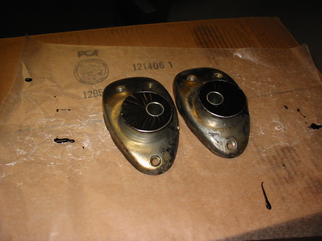

My first attempt to get more negative...my wife says I'm always too negative.
Just poured these yesterday, gotta wait for em to cure up gud.
Chris, thanks for the support plates! (IMG:style_emoticons/default/aktion035.gif)

That looks interesting. What exactally have you got going on there?

Joe Ricard   How plyable is that stuff you poured? Just asking ...   Jul 25 2007, 12:48 PM
Borderline   I popped out the stock bushing/rubber grommet and ...   Jul 25 2007, 02:12 PM

Joe Ricard   We use this stuff called "chock fast" Mo...   Jul 25 2007, 04:00 PM
Borderline   The RTV thing is a two component polyurethane that...   Jul 26 2007, 11:08 PM
