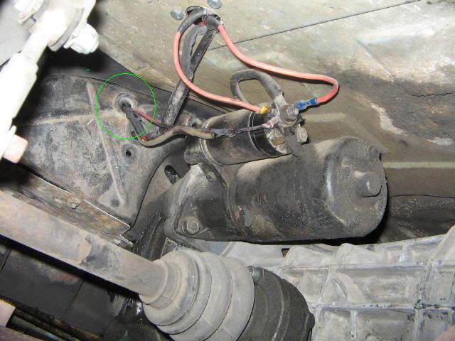

Had a wire do that on a car I had (not a porsche) about 15 years ago.........result of a direct short to ground. filled the cabin with lots of white smoke.
I would look at the grommet in the area I circled in green. The wire I had this happen to passed thru an old grommet and finally the sheet metal cut thru the insulation. It is the only thing I know of that will fry the insulation off the entire wire or cable that fast.
Hope this helps,
