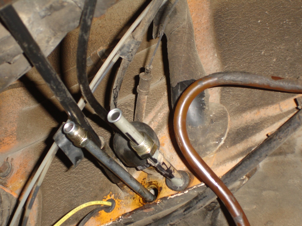

I am trying to install my stainless steel fuel lines on my 72 4 and have encountered some strange stuff where the lines exit the tunnel in to the engine compartment. anyone have a pic of how it should be??? this is how mine is.
Not too sure whats up with the 1/4" steel plate on the clutch cable... Needless to say I have work to do before installing the stainless lines...

hope this might help

slim72914   Yes that helps alot! Ill have to make a p...   Aug 19 2007, 01:25 AM
Phoenix-MN   Here's another angle that might help (with Tan...   Aug 19 2007, 07:49 AM
jasons   So do you even have the tube that runs through the...   Aug 19 2007, 09:45 AM
rhodyguy   there's a sawsall party in colorado today. if ...   Aug 19 2007, 10:17 AM
So.Cal.914   there's a sawsall party in colorado today. if...   Aug 19 2007, 11:15 AM
Bartlett 914   Here is a picture of my car showing the tubes in t...   Aug 19 2007, 10:30 AM
slim72914   It was indeed very poorly fixed once... There is n...   Aug 19 2007, 10:59 AM
rhodyguy   the party is mentioned/detailed in the classifieds...   Aug 19 2007, 11:34 AM
dinomium   the party is mentioned/detailed in the classified...   Aug 21 2007, 01:36 PM
slim72914   I like to do stuff the wrong way so ill machine me...   Aug 20 2007, 11:49 PM
Bartlett 914   The repair I made on mine as shown in the picture ...   Aug 21 2007, 01:20 PM
John   Here is a picture of mine. Sorry it's not a r...   Aug 21 2007, 03:56 PM
slim72914   OK I got to digging around again last night and fo...   Aug 21 2007, 10:08 PM
Bartlett 914   Yes you need the tube! It must be welded to th...   Aug 22 2007, 08:58 AM
slim72914   So what is the most important part of the clutch t...   Aug 23 2007, 12:55 AM
Bartlett 914   The missing section of the tube sure complicates t...   Aug 23 2007, 07:12 AM
slim72914   I planned on making my patch out of stainless stee...   Aug 23 2007, 08:52 AM
Bartlett 914   I planned on making my patch out of stainless ste...   Aug 23 2007, 09:19 AM
slim72914   Yes it is broken off at the front too.. it is just...   Aug 23 2007, 02:43 PM
Bartlett 914   Go back and look at the picture I posted. You can ...   Aug 23 2007, 03:29 PM
