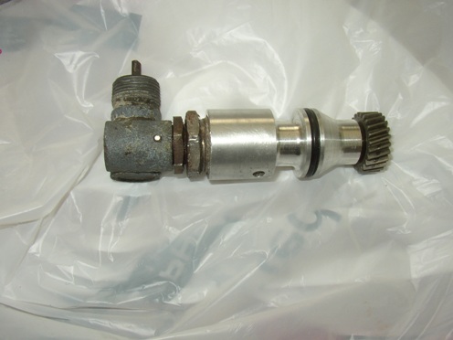

picture below shows a variation on the angle drive. Note that there are two nuts on this one. The smaller one locks the angle drive onto the shaft- don't touch it.
This drive is from a car with a 08 72 build date. My new car has a 03 73 build date and has an angle drive like the one Mike is showing here.
