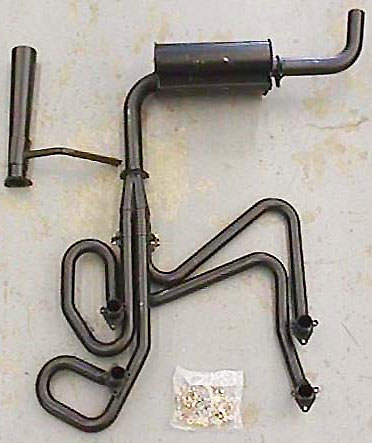

Let me get your guys' opinion. I think I found a header setup from patrick motorsports (awesome to me, since my name's patrick too!)
It's $788, a thousand less than a tangerine and god only knows how much SSI's and a bursch would cost, and i dont need HE's since I never plan on putting heat in this car.
I've attached a pic of it. Let me know if you guys have any experience with this setup.
Thanks in advance!!
