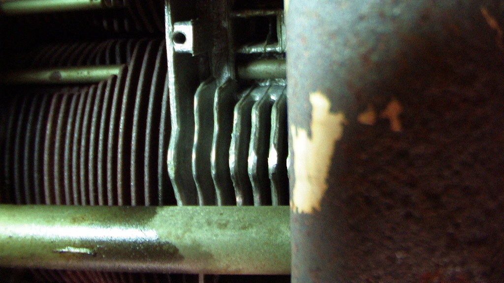

Here is a pic of the driver's side cylinders. There should be a metal plate that guides the air, right? The passenger side has what's called a 'baffle plate' according to pelican. I can see the screw hole where it would mount too.

toon1   Here is a pic of the driver's side cylinders....   Sep 14 2007, 10:52 AM
