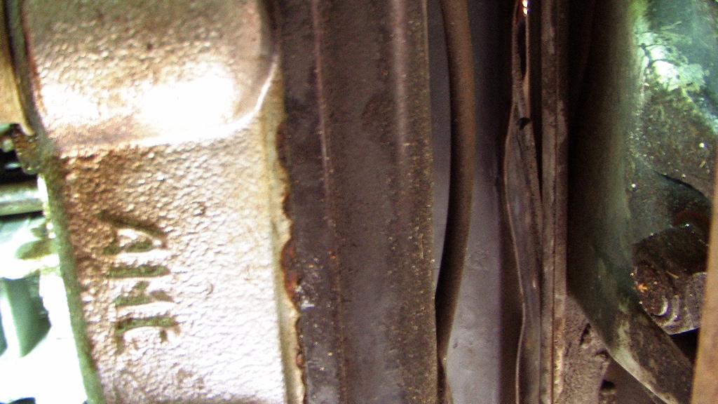

And for those that doubt it... Here are pics of the heads, at least as much of a pic as I can get, it's hard to swing a camcorder around under there and I can zoom out only so much with the limited clearance I have under there.
See...AMC heads.
I'm not even doubting that this is a bus engine. The person who did this to my car can probably be best described as 'ham-fisted'.
