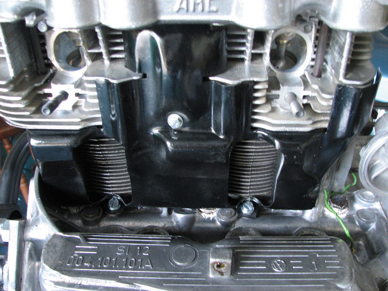

purple   Here is a pic of the driver's side cylinders. ...   Sep 14 2007, 10:09 AM

toon1   Here is a pic of the driver's side cylinders....   Sep 14 2007, 10:52 AM
