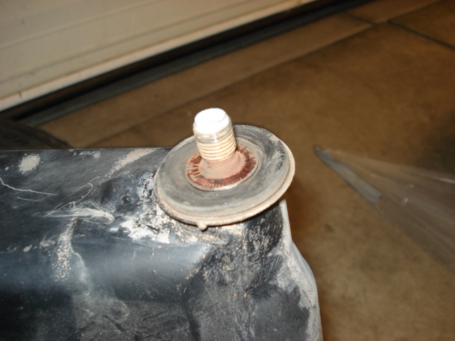

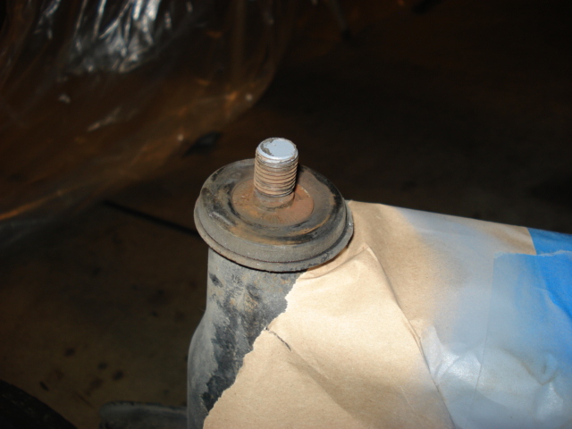

I pulled the trailing arms today and the bushings look ok.
HOw can I check them to see if they are still usable?
Will the stock bushings survive powder coating?

ConeDodger   I do not think the bushings will survive. Even if ...   Sep 11 2007, 11:49 PM
