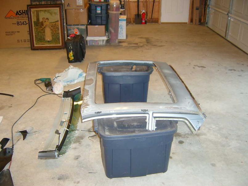

The first thing I started with was a handful of measurements and compound curve demensions. Then my son and I zipped on down to a local bone yard and started checking out roofs on various cars. I wanted to keep it in the "Porsche family" or at least in the P-VW-Audi family, so we started there. Turns out, the 944 has an almost spot on match to the first main raidus required for the job. Hmm, $100 and a sawzall later and we had the top of a 944 sitting back at the house. Here is the basic starting piece I had. This is where the fun and frustrations began. (IMG:style_emoticons/default/wink.gif)
My first cut was for the front, measured from the windshield frame back to where I figured the back should end correctly. I studied 100 916 photos and had them plastered everywhere during this whole process.
