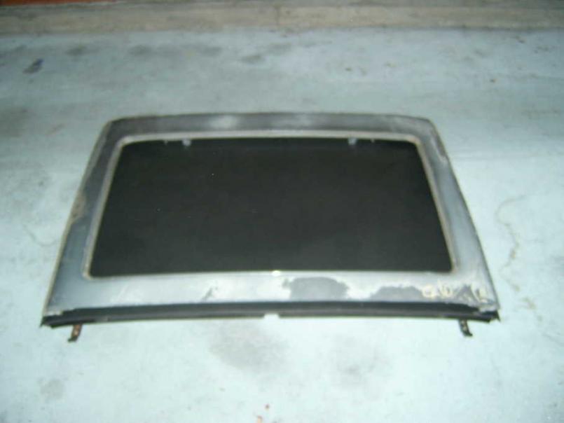

This is one crappy photo, sorry about that. But after cutting off much of the sides that would meet up with the doors and rear quarter windows, I was able to start laying the steel section on top of a 914 top to start getting ideas of where to go from here. One thing I noticed right away was I was going to have to create something to add about 1 inch to each side and make it have a compound raidus. Nothing like keeping it simple huh? (IMG:style_emoticons/default/sad.gif)
