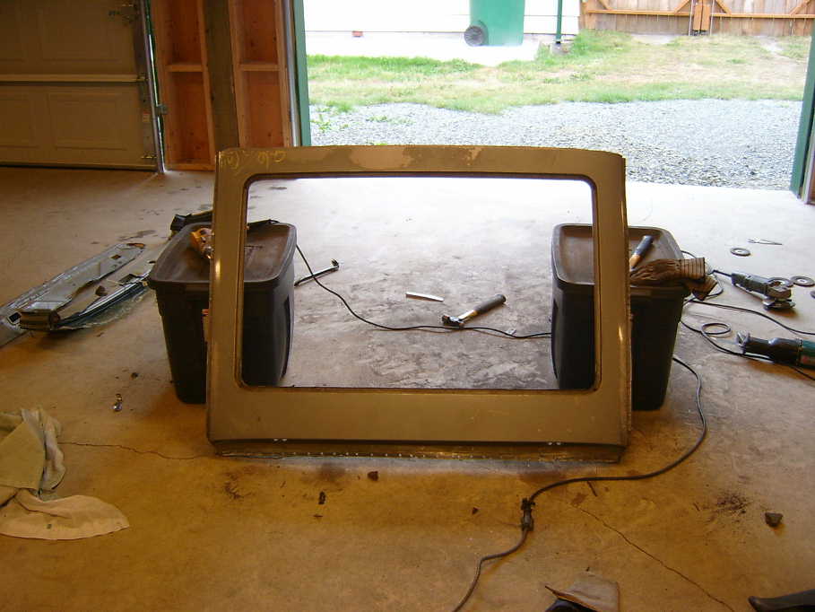

This is not a project for any sort of beginer or not anything I would recomend for anyone who cannot do it all themselves. I spent waaaaay too many hours to justify having an actual shop try it. I also probably wouldn't ever do this again for fear that I wouldn't be able to reproduce the same results. Yeah, it turned out that good. That said, as I post pictures, understand this project is already DONE. So it WORKS and looks as though the factory installed every piece. So sit back, enjoy and maybe dream that you might one day yourself embark on such a task. Hopefully this will help those few people who dare to be as stupid as I. (IMG:style_emoticons/default/screwy.gif)

Same as the last shot I posted, just from the other side. Yes, I have 4 saw horses and 8 pairs of jackstands. (IMG:style_emoticons/default/biggrin.gif) You can see on the bottom one of my first versions was leaving that nice finished edge on from the 944. It seemed perfect, the way it sloped back in just like the 916, smooth factory finished edge even. Eventually, I found it just too much for me to make look "perfect". So it got cut off down the road. I'll show you what I did in its place.

Root_Werks   One of the local guys (Jeff H.) let me cut the rea...   Sep 17 2007, 10:44 PM
Root_Werks   Here is another good shot of the two tops sitting ...   Sep 17 2007, 10:48 PM
Root_Werks   Here are those saw horses with the donor 914 top p...   Sep 17 2007, 10:51 PM
