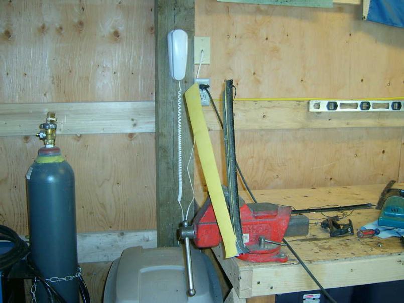

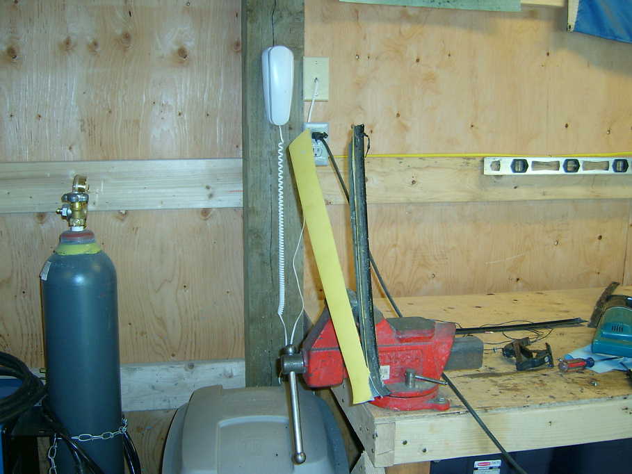

One of the local guys (Jeff H.) let me cut the rear targa roll bar and front winshield frame sections off of a soon to be scrapped 914. I learned very quickly I wouldn't have been able to do this without those pieces. You simply have to have them to help design and build the needed compound curves for the roof section. Here is another tossed out idea I had of cutting part of the windshield frame up to use and weld to the top to creat an exact 914 "curve". I never got to welding it on, I wound up building this part from scratch. Yuck.
