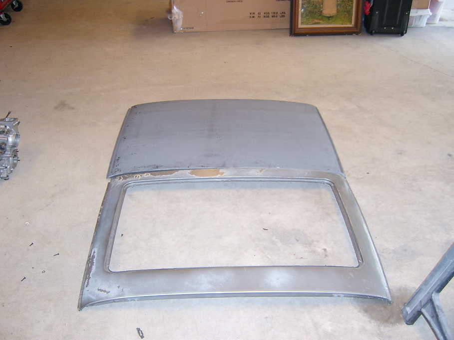

Root_Werks
post Sep 17 2007, 10:48 PM
Village Idiot
Posts: 9,088
Joined: 25-May 04
From: About 15NM from Canada
Member No.: 2,105
Here is another good shot of the two tops sitting close together. You can see how the main roof arc is almost a spot on match but still not quite wide enough.

Root_Werks   Here is another good shot of the two tops sitting ...   Sep 17 2007, 10:48 PM
